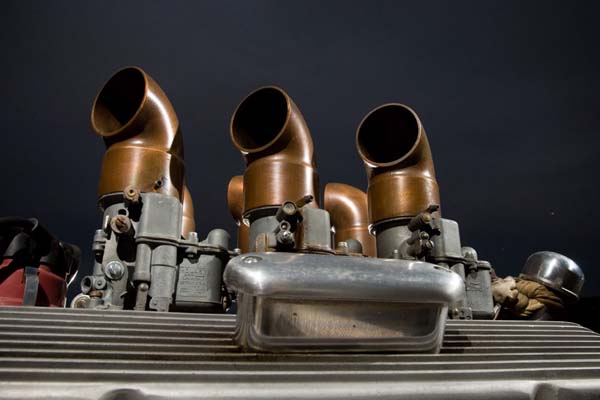

The yellow paint is just how he bought it. He cut 6 & a half inches out of the roof height and channelled the body 7 inches over the chassis rails. The chassis itself was built from scratch with a 6 inch kick-up in the front and a huge 14 inches in the back. The motor’s a 350 small block Chevy, with 6 deuce carbs, a 350 gearbox and 9 inch Ford rear axle.

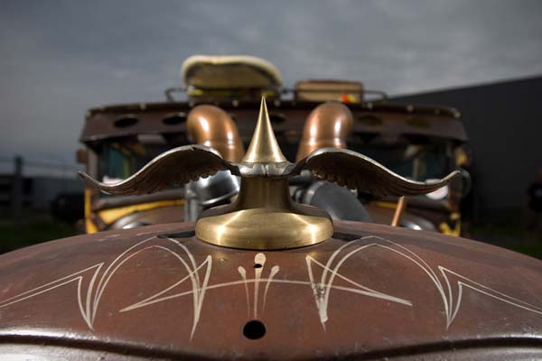

The little yellow sedan was then bought through Ebay about 8 months ago by Dutch rodder, Frank Vangeffen. In the short time he’s owned it he’s already made several changes to stamp his own mark on it, such as new taillights, new exhausts & a lower seat height. He also made the funky winged grille ornament. Frank’s completely treated the rod with “Owatrol”, a clear coating that can be used on any kind of surface, even wood. It keeps rust from spreading further as the weather in Holland is kind of wet. The steering wheel was swapped for one from a '57 Chevy, because the one that was in it was too big for him to be able to see through the windshield!
